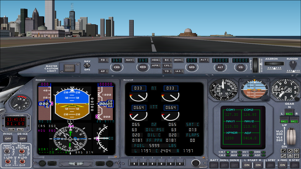

Learjet 45, my first jet in...
LONG LIVE MEIGS FIELD!!!!
