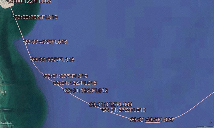

Incident: Qatar B788 at Doha on Jan 10th 2023, steep descent after takeoff
By Simon Hradecky, created Tuesday, Feb 7th 2023 17:21Z, last updated Tuesday, Feb 7th 2023 17:26Z
A Qatar Airways Boeing 787-8, registration A7-BCO performing flight QR-161 from Doha (Qatar) to Copenhagen (Denmark), departed Doha's runway 16L in night time conditions at 02:00L (23:00Z Jan 9th) and had climbed to about 1800 feet when the aircraft entered a steep descent losing 1000 feet within 24 seconds. The aircraft was subsequently recovered, climbed out and continued to Copenhagen where the aircraft landed safely about 6 hours later.
According to information The Aviation Herald received on Feb 7th 2023 the first officer was pilot flying. At about 1600 feet the aircraft was cleared direct to the next waypoint and the first officer attempted to turn towards that waypoint flying manually and without flight director indications (the captain was slow to put the Direct into the FMS) but lost situational awareness sending the aircraft into a descent that reached 3000 fpm sink rate and exceeded the flap speed limits until the captain took control of the aircraft and recovered about 800 feet above water. The occurrence was not reported to the authorities and only came to light later.
ADS-B Data show the aircraft reached about 1850 feet MSL measured to standard pressure (QNH 1013) then entered a descent reaching 850 feet (standard pressure) 24 seconds later while turning from 157 degrees true (runway heading) to about 110 degrees true, the aircraft subsequently levelled off momentarily and began to climb again.

Map and flight trajectory based on ADS-B (Graphics: AVH/Google Earth):​
