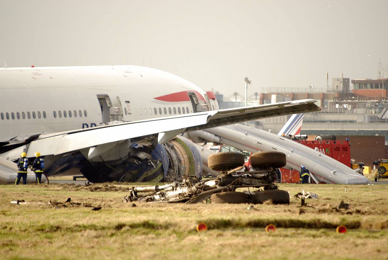

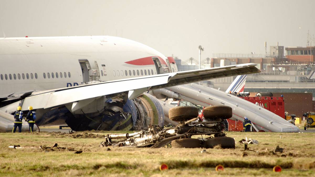

I keep thinking of the British Airway Heathrow crash of 2008 that lost both engines on final. Wonder if a similar situation could be going on here. Obviously very different aircraft.
It was a fairly short flight and the Fuel Cooled Oil Cooler transfers a good amount of heat to the fuel on the way to the engines.
Here is a screen capture from a video in our 604 showing the fuel is over 80C°
