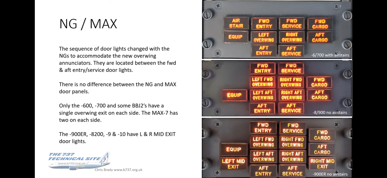

Oh man, wasn’t joking but was forgetting what a POS the 737 is. So there is no indication when a door is open??Not sure if you're joking or not......Does a 737 have any "page?" Or just recall lights?
yes, you will get a master caution and a doors annunciator cueing you to look at the overhead panel. Not sure if the plugged door is wired into that.Oh man, wasn’t joking but was forgetting what a POS the 737 is. So there is no indication when a door is open??
Ok, does it alert to a specific door? But this was my main question if that false door is wired. Just curious.yes, you will get a master caution and a doors annunciator cueing you to look at the overhead panel. Not sure if the plugged door is wired into that.
When you screw up your neck looking over your shoulder you will see a block of annunciator lights and whichever door is open will be illuminated. But yeah not sure about the false door. I guess if you found a high-def picture of a Max overhead panel you might could tell.Ok, does it alert to a specific door? But this was my main question if that false door is wired. Just curious.

This video from the 737 Tech Site says the overhead door lamps panels are the same between the NG and MAXX (but not of deactivation of the door includes the lamp).
View: https://youtu.be/WLfT5WJz-6s
I believe that to be true.So would this have been the mid left exit?
This video from the 737 Tech Site says the overhead door lamp panels are the same between the NG and MAXX (but not if deactivation of the door includes the lamp).
