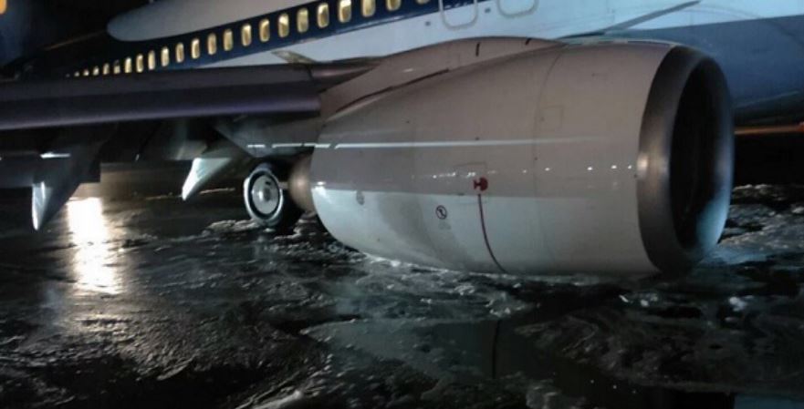

I wouldn’t rule out a metallurgy issue as a result of manufacturing or overhaul as well.
I was looking into the aft trunnion pin because I was curious about the material, and it’s evidently 4340M alloy steel heat treated to 275-300ksi (pretty dang strong!), with chrome plating.
More interesting was the fact that this same failure mode has happened to a couple of 737s in India relatively recently - a 737-900 in 2016 and a 737-800 in 2015:
Not pinging on any manufacturer in particular, but the last 5-10 years, I’ve noticed that metallurgy in general has gotten really sloppy.
Heat treated parts that aren’t, really weird corrosion modes on new parts, spalling where there should never be any, just a whole new level of WTFery.
We’ve either forgotten how to make stuff, or they just accept the crap that comes in a box with no QC.
Nice job skipper.....all things considered. Kinda wild that such a massive gear failure would be so imperceptible that the FO just did the after landing flow. Also, if you guys think 1.7 Nz is a lot, it isn't *on the mains at least*. Probably not a "good" landing in PHX on a nice day, but running off the end of the runway is a much worse landing as one fishes for the right ROD. On that note, I'll have the stick in my lap at 7G tomorrow before some of you are even awake. Suck it :)
Are you a 129 Growler IP? There’s already talk of putting g-limits on Growlers. Have fun while G’s are free.
I smell a fleetwide AD coming on...
ASB first to describe and instruct, AD to follow shortly thereafter. I suppose because of the size of the fleet and scheduling of flights it could turn into a big deal. I've never worked on a 737 but I've removed and replaced landing gear on large cabin private jets plenty of times, it's not really difficult you just need to realize the scale and weight of the parts and act accordingly.
