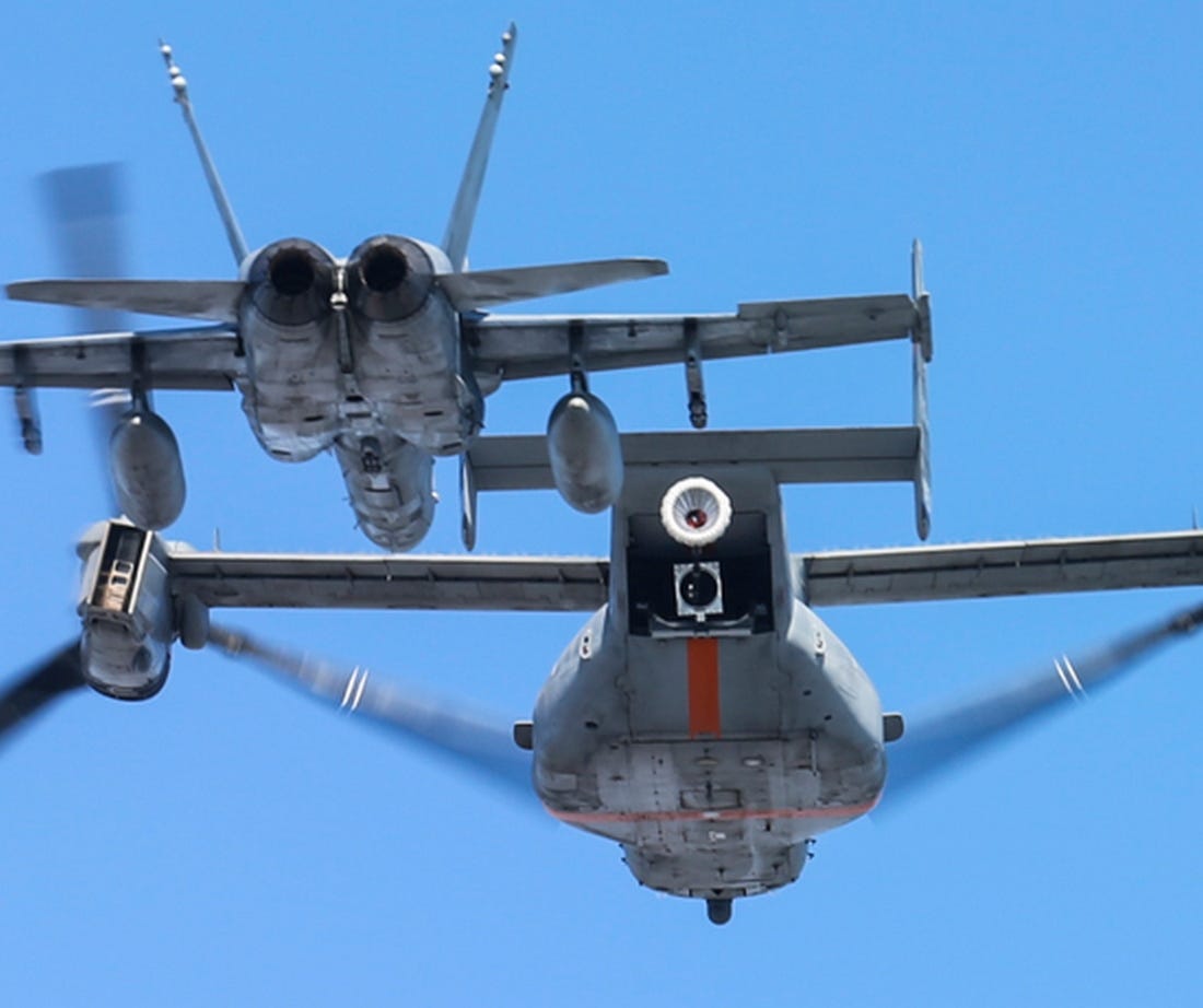

See that the USMC has made a tanker fit for the V-22? Apparently certed for F/A-18, AV-8, F-35, and CH-53 receivers.
Probably at least as un-fun as tanking off a KC-130 in the Hornet. 217 knots IAS, plus prop wash and lightweight MPRS style pods/baskets. Not exactly the ideal regime to tank. Though that was my first tanking experience as a RAG student and it went ok, so I suppose it couldn't have been that hard.
I simply can't see what that's not at least a little fixed-wing.
