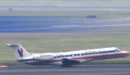

What brazilian maniac though up that system? I remember reading about that incident and going...WTF? How does the system give you 3 greens for gear not just unlocked, but still in the frikkin wheel wells?
The LGEU "le-goo" was completely jacked- sent a non-programmed erroneous signal. No other EICAS indications that should correspond with a gear problem were indicated. All else appeared normal...
... Jet Blue sat and watched them do it...
.. and then the FO went.. "Hey, this ain't right.."
... and that's how you get the world's only successful gear up touch-and-go. :D
At least that's how they tell the story in the school house.
We were told in initial that they DID have an EICAS message indicating a problem, told us which one it was, and said that just because the EICAS indicates gear down and three green does not mean it's true when associated with the above mentioned EICAS message.
That may or may not be correct, but it's what we were told, and I got the impression EMB went bat crazy sending that information along to every EMB-145 operator out there so the same mistake wouldn't happen again.
Maybe I recall incorrectly. I think there was a gear/lever disagree, but it indicated 3 green, and all other indications appeared normal.
I ferget. Either way, the point I recall was that the malfunction was completely outside the logic tree- it was something the crew kind of had to just interpolate. They interpolated incorrectly, but based on the scenario, the LGEU should have never given a 3 Green indication. That's what they let lead them astray.
The part that hurts is the aircraft sitting short of 22R that just sat and watched... LOL
