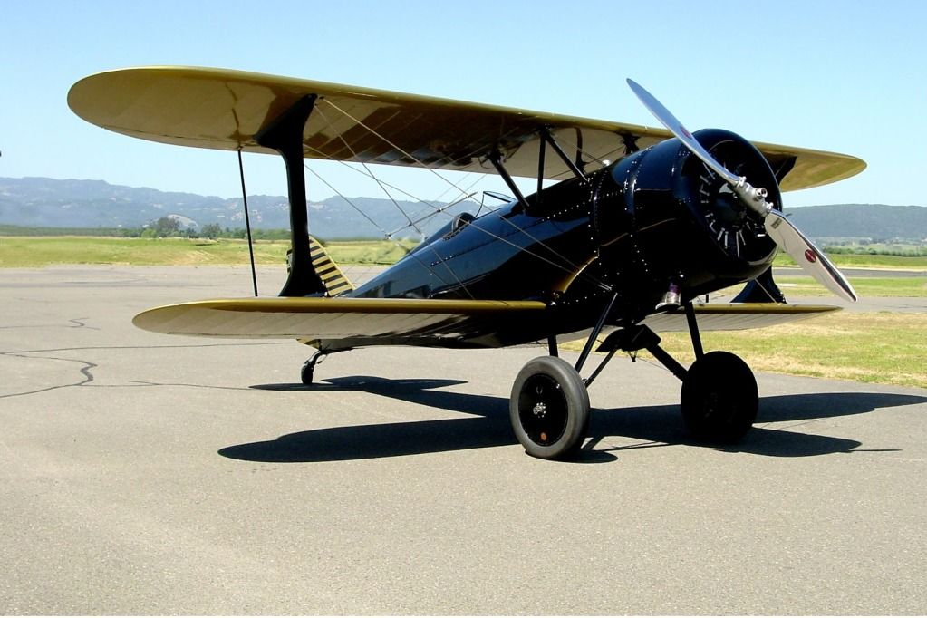

I would wheel land this. I would also three-point it. I would sell my daughter for it.
