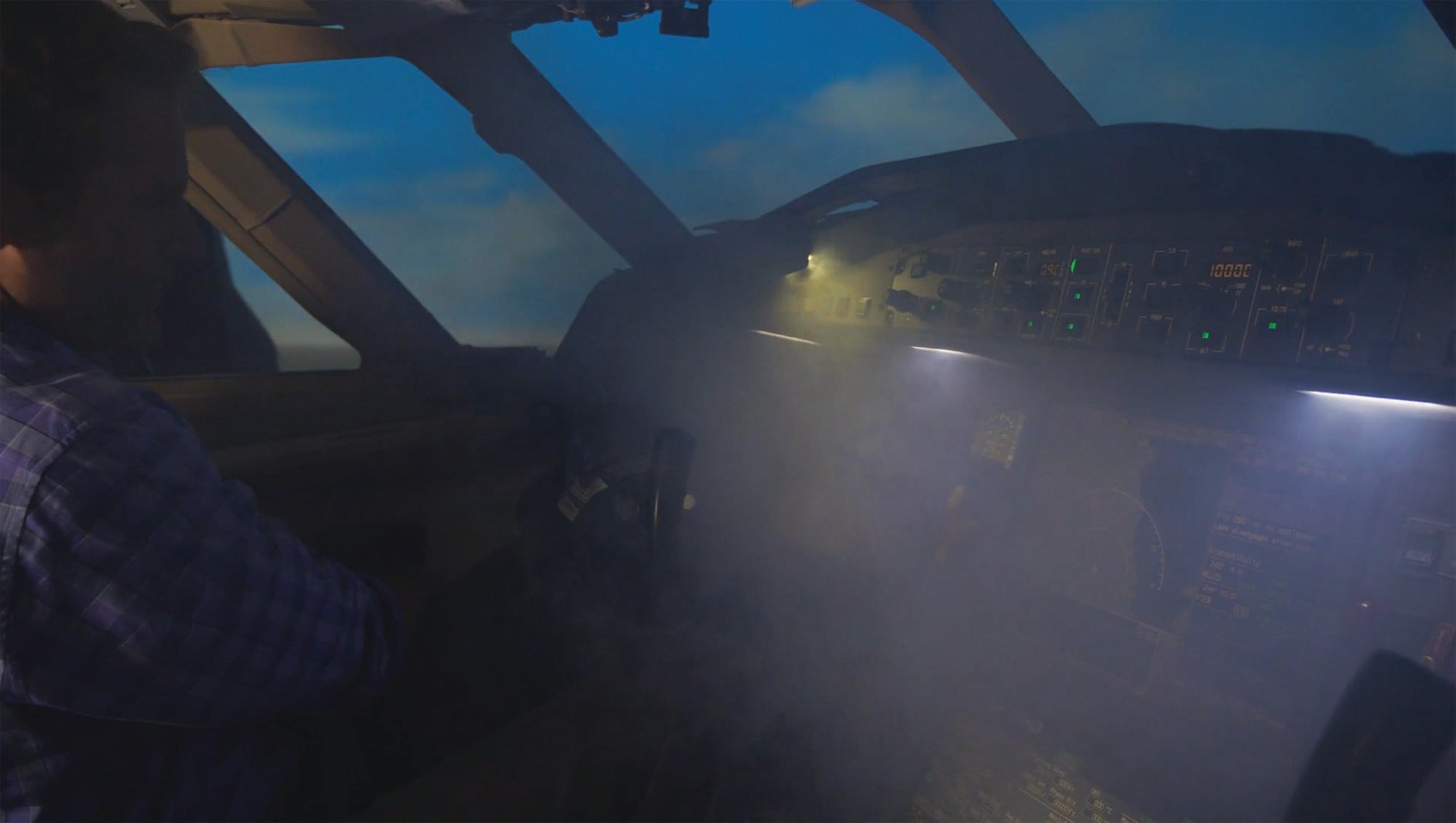

I saw this article and wanted to pass it along. It got me thinking about the blind drills and other things the big box 142 centers don’t cover.
If you’re doing single-pilot training, dubbed “the hardest type in the building” at FSI Wichita, here are a couple of things to keep in mind:
I believe most G1000 350s are older models and don’t have the Keith AC. This is what the Right Pilot Subpanel should look like and where the bleed air valve switches are. They’re pull-to-move, locking position switches, but so is the ENVR BLEED AIR switch to the left.
Air Start CLs aren’t memory items, but you should be familiar with the sequence.
AP malfunction/pitch trim runaway: if you’re fighting to control the airplane, you can’t very well pull out a checklist to find Step 4 after you’ve done the memory items. Step 5 is important and challenging for the single pilot. Again, I wish I could post the pic, but remeber the AFCS SEVROS CB is on the right (copilot side) CB panel, 4th row down, all the way to the right.
Also, it’s a PITA to get to the Alt Static from the left seat.
When you’re going through the pre-study material, just think about the EPs in that manner, “What am I doing at this point, and what do I have to do next?” TAWS, GPWS, Windshear events all have a CL with non-bold steps.
Finally, don’t rush anything and don’t let the instructor or DPE rush you.
