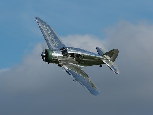

If he's into a high performance single, I would recommend the Spartan Executive. If he wants a twin, definately a Lockheed Lodestar. Anything less would not be masculine.
Lol! I think he's looking for something just a liiiittle bit on the newer side.

Cool airplanes Waco, but not practical. MX costs alone would eat most people for breakfast. Those airplanes should only be enjoyed by those who can appreciate them. And this guys boss just see's them as a tool in his tool box, nothing more. I'd hate to see one get used up in this role. The should be treated like a fine wine, only brought out on special occosaions.

Honestly, what is wrong with these? :dunno:
No doubt they are cool planes, but good luck finding people who can work on either one when you are on a trip and something breaks. They built 625 Lodestar's. I've seen numbers indicating between 10 and 15 still being airworthy, and I've seen a couple "project" airframes for sale in the last year.
I'm going to have a Lodestar someday. And a Lockheed Orion. And a Lockheed Air Express. And maybe a flyable replica of an Alpha. Lockheed used to build some kick-ass machines.
Nothing, other than the fact that there are not to many left, and they should be preserved for future generations to enjoy. Putting an airplane like that back to work vs enjoying it as the history piece it is, is next to blasphemy. Don't destroy it by working it to death. They are like retired race horses. They should be relaxing in a climate controlled hanger and flown when the urge hits. Working planes get beat up on, and I bet parts are hard to find, if availible at all.
Edit to add: Beat something up that has no real historical signifigance.
There must be a healthy mix. Let them sit too long and seals and other stuff dry up. But I mostly agree. For a daily driver I'd probably do a Beech 18 - plentiful and MUCH more budget friendly feeding two R-985's than two big Wrights or Pratts (depending on the model of Lodestar). Probably I'd want a Howard 500 that had R-2800's.
