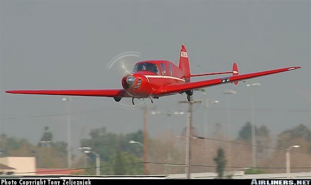

Wasn't aware of wood pieces on the Bonanza - only fabric covered flaps and ailerons on the earlier ones. Wood alone shouldn't be scary. The Bellanca's, if you find one in good shape that has been cared for, will fly circles around the Bonanza on their wood wings, and I don't thinking Bellanca's have had as many structural failures as the V-tail.
And, for the record - I like V-tails, but would never spend my own money on one - I would most certainly get its contemporary, a Cessna 195. If I was forced to get a flat-motored airplane I would get a Bellanca Cruisemaster for a traveling machine.
