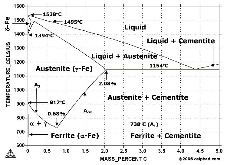

I'm not a metallurgist either, but happened to take a test on this topic in my lower division materials science class the day of this post (it's been an interesting class!). FWIW, Austenitic refers to a phase in an Iron-Carbon system (i.e. steel) called Austenite, which is found when the iron is heated up past a certain temperature (~800 C) with a certain weight percent of Carbon (~0.7) dissolved in. This changes the atomic structure from BCC to FCC and yields some favorable hardness or ductility characteristics. I guess to retain the microscopic Austenite structure at room temperature they alloy it with manganese or nickel which produces Austenitic Stainless Steel.
Please correct me if I'm wrong since I only learned about all this in the last two weeks.
You can find it on this graph, which relates temperature to weight percent carbon:
[/7500]
[/7500]
That is some cool, good to know information, inigo! What are you majoring in?
