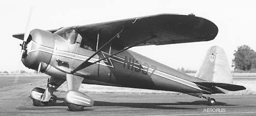

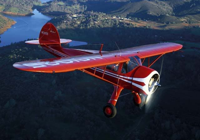

The first Luscombe was the Luscombe Phantom, which featured a 145 HP Warner. Absolutely beautiful machine and you can really see a lot of Monocoupe D-145 in that airplane.

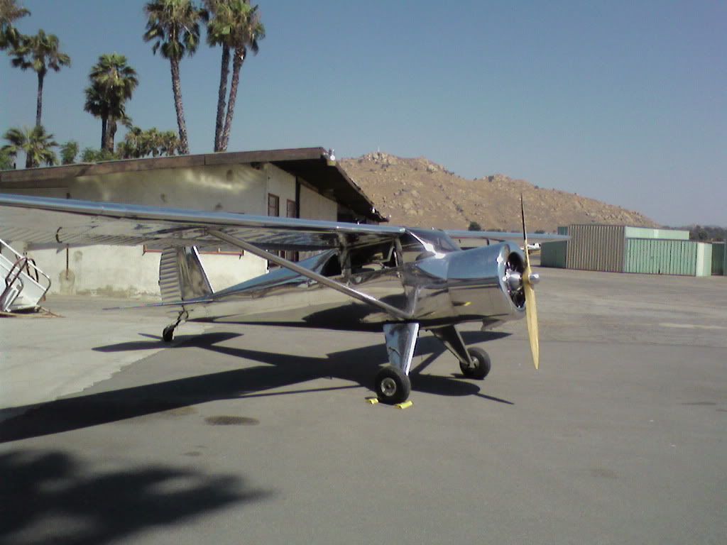

After the Phantom, there was a smaller machine made - akin in size to the Model 8 series - but with a 90 HP Warner. This is what the new Luscombe people were going for. The only thing I don't like about the looks of the Rotec installation is that it is mounted way far foward (compared to the model 4) and the sheet metal where the cowling meets the fuselage is awkward. The model 4 was designed to have the Warner, whereas the airplane in the link was designed for an O-200 and the sheet metal reflects that. Still a pretty airplane though.
The thing that I don't understand with the new Luscbome people, is I haven't seen them at any of the show's I've been to in the last year. Not at the US Light Sport Expo for the last two years, they weren't at Sun'N'Fun last year, and they weren't at the AOPA expo this fall. One of the reasons the big LSA companies get so many planes out the door, is they show up with huge setups at the airshows. They do lots of demonstration flights, and get people generally talking about their airplanes. Without showing up to the big shows, Luscombe isn't really helping themselves at all.
And to further the Luscombe thing, to supplement my previous post:
The Phantom - 145hp Warner.
Luscombe Model 4 (90hp Warner):
