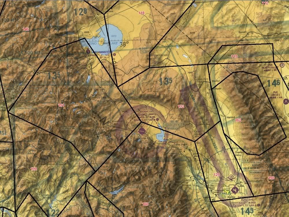

If KMMH had an approach control quality radar on the airport, ATC could be of no help with avoidance of close-in obstacles below the MVA. With such a radar, the MVA sectors could be smaller and lower than the present Oakland Center MIAs (centers use MIAs, TRACONs use MVAs) but such an MVA would likely still be at least 4,000 feet above the airport. And, the real terrain threat as MMH is below 4,000 feet, agl, at least for takeoff on Runway 27. Runway 27 is a very high risk terrain environment. Runway 9, however is not all that demanding for turbine-powered airplanes with good performance.
As to radar coverage, or lack thereof, it doesn't matter once you achieved MEA on V381. The tricky part is turning around over the BIH VOR with higher mountains on both sides of you.
This is a very poorly designed ODP that is very old and predates the RNAV IAP for the airport. The airport would be far better served by an RNAV ODP, thus avoided having to go SE to BIH VOR then reverse course to get established on V381. But, even with a well-designed RNAV ODP departure on Runway 27 would still be a high-risk maneuver in IMC, or even at night.
And, for commercial operators, compliance with OEI requirements on 27 is really tough unless you're flying a high-end Falcon or Gulfstream.
As to radar coverage there is none, not that it would help in the early stages of a departure anyway. And, there is no capability of communicating with the center until well east and line of sight of KBIH where the center frequency of 125.75 is remoted (as well as in the Tonopah area). The center's radar is also located in the Tonopah area and is blocked by the White Mountains below 16,000 to 17,000 in the area of MMH and BIH. Radar coverage improves dramatically once line of sight north of the north end of the White Mountains.
As to assessing the terrain close in to MMH, which the FAA has done for you with the ODP, only a USGS 1:24,000 topo map is up to that task.
I have attached the Oakland Center MIAs for the area, which in no means assures radar coverage:
It is NEVER ATC's primary function to keep you out of the rocks, their job is AIR TRAFFIC. They are supposed to keep you from hitting flying metal objects, that is all!
