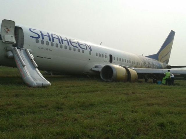

Since we're talking about two pilot aircraft.
Three items caught my attention in the article.
  • The report mentioned that the pilot could not maintain the balance of the aircraft and also ignored the advice of his co-pilot, reported Dunya News.
  • The investigation also showed that the pilot ignored his co-pilot’s advice and despite high speed he landed the aircraft instead of slowing it down before the landing.
  • The report said that the aircraft can not be used again
http://www.kathrynsreport.com/2015/11/boeing-737-4h6-shaheen-air-ap-bjo.html
