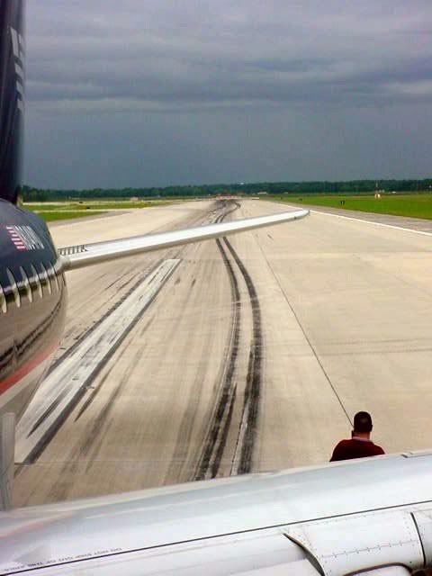

a friend from the airport auth. passed them along. It happened in Houston the other day.
Wow, wonder why the brake was on in flight in the first place?
Also did a nice job keeping it as much center as possible!
It wasnt a 73
That was an Embraer 170, not a 737. They have the whole series of pics posted in the xjt crewroom in houston.

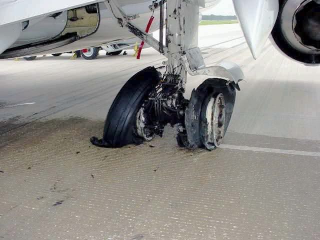

You guys say good job on keeping the aircraft at centerline. But the wheels are pretty much gone so the whole thing is probably dug in the ground anyways. Without wheels to go sideways how would you get out of centerline anyways? Same thign on the Jetblue flight. Please correct me if I'm wrong, but this seems logical to me.

YEs, the wheels are gone and the gear have dug in to the pavement... But you have answered your own question. Think for a second.....If the gear is diggin in on one side there will be more pulling force to that side. Therefore, it will make it much harder to keep the plane from pulling in one direction. That would indeed make it harder to keep it on the centerline. Look at it from your car standpoint. If the brakes are completely gone on one side and you slam them on, your car will pull to that side where the brakes are good. You would have to counteract that by turning the wheels opposite of the 'good' brakes to keep it going straight.
