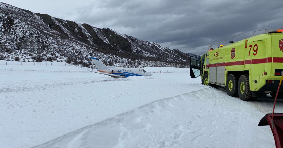

Departing runway 33 when the wind is 16016G25KT
KASE 211853Z 16016G25KT 10SM FEW036 BKN060 01/M09 A2961 RMK AO2 PK WND 17027/1841 SLP988 T00111094
Wonder what their performance showed for that tailwind component? 33 is used for most departures there, as 15 departures have terrain clearance issues. Used to be that prior permission was required to be had before being able to depart on 15; may still be the case.
ASE crash-fire-rescue is one of the busiest units out there, with real world incidents seemingly a somewhat regular occurrence.
"Aspen airport PERMANENTLY CLOSED TO AIR CARRIER OPERATIONS after private aircraft 'goes off the runway'..."

Never going to happen. Convenience is everything to them. I wonder how much pressure was put on them to take off.

I've never flown into Aspen but......sounds like it's controlled. The tower doesn't see the winds and say we're turning the airport around? Yes I know..."yer the PIC!" Still...between the PIC and tower you'd think someone would say something. Unless the wind shift was fairly recent...

"Instantaneous winds" is a thing there. Usually one direction in and the opposite way out.

Also, for better or worse the tower controllers are savvy to the 10kt tailwind limitation on many jets, and will report instantaneous winds as slightly lower to help "move things along".
I've definitely gone out of there with a slight <10kts no gusts tailwind, but I can't imagine the pressure on a Hawker captain electing to go in gusting winds over 20.
And to add to it, Rwy 33 is 2% downhill!

They’re amazing at normalizing deviance. “Instantaneous winds” like the way they do it are asking for an accident. Yes, it takes two and most pilots play along. Just give the real winds. If it’s close and a wind check might help I’ll ask. When it’s a 20+ kt tailwind and you say “I’ll find you some good winds…” you’re helping line up the holes in the Swiss cheese.

Because it’s a very mountainous airport surrounded by high terrain. It isn’t Wichita. One way in (R15), one way out (R33) for most jets.
Even better, on VMC days, tower points out traffic on 9 mile final to Rwy 15. You have to call traffic in sight, then the tower clears you for takeoff on Rwy 33.…. Then the tower tells the guy landing, departing traffic has you in sight, cleared to land 15.

I was in ASE yesterday when this happened, in fact we drove by the aircraft out in the snow on the way to the hotel. I don't know much, but when we landed earlier (winds were 170/11G16 or something like that) the airport was so packed we had to wait in the deice pad for 40ish minutes before rolling into Atlantic Aviation. While we waited the winds got pretty gusty, as mentioned above 160/16G25 or something. Tower was liberally using instantaneous wind reports. Both myself and my FO were fairly sure that the reality was most of the aircraft taking off were well outside the fairly standard 10kt tailwind limit on most jets. I think the instantaneous wind reports they do in ASE is more or less playing with fire. ASE is dangerous enough on a normal day.
ASE should closed and turned into a high end mall. The relative lack of accidents in Aspen is more a testament to luck than the median skill of the pilots operating there. It’s only going to get worse as the airlines continue to suck talent/experience out of the 91/135 world.

I think it was a Mexico-registered plane a few years ago that asked for winds four times on final. Each time the tower lowered the number until the pilot accepted, he slammed it on and then crashed (Killed one IIRC).
