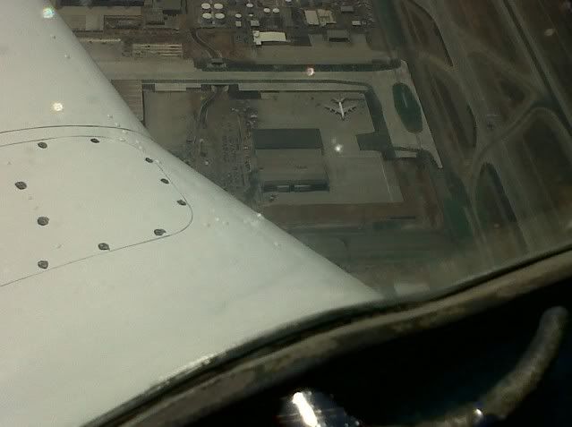

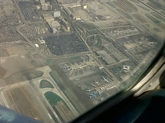

I like going right over LAX, great views. Just go under the shelf north of Santa Monica, then follow directions on the TAC: into the Special flight rules area 3,500' southeast bound, track off of Santa Monica, squawk 1201, and self announce.....it's easy like sunday morning.
EDIT: No VOR? (Just read that part.)....Errr....drive.
And when else can you say you've seen an A380 from above.....
