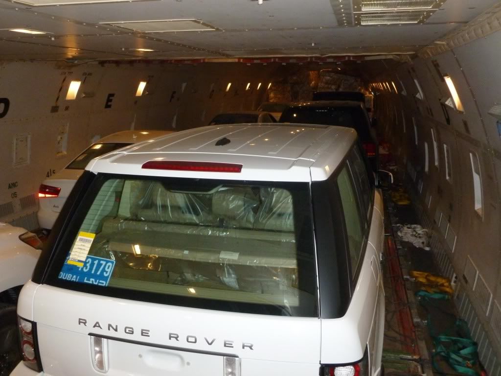

Cars actually don't weigh that much compared to normal freight. I carried a load of SUV's and Mercedes-Benzes from Dubai to Almaty a few weeks back. Granted we had a bunch of regular pallets in the back and I don't remember how full the lower lobes were, but if I recall correctly were only carrying about 60 tons of payload whereas a full load is closer to 115ish. They were driving the cars around inside the airplane to position them correctly, so i guess they weren't doing anything too special in regard to batteries or fuel tanks.

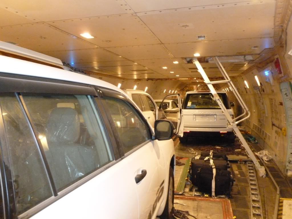

HA HA I love the two bags tied down in the bottom pic
Ha, that's more than two (5!)! That's our "crew bag storage area" because it gets surprisingly cramped on a 74 freighter upper deck with 5 guys up there for 18 hours. We had three captains, one f/o (me) and one loadmaster on this flight; after offloading all the payload in Almaty we continued empty to Shanghai.
