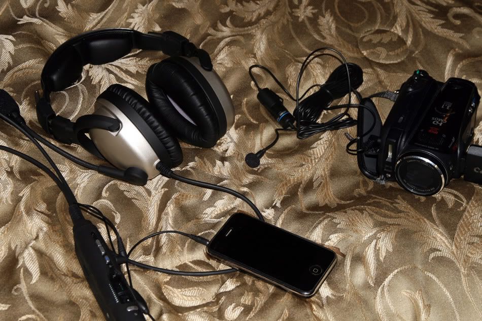

Has anyone rigged a Canon XL2 camera so that all they get is the radio/intercom noise in the aircraft?
I was thinking the probably the best way to do this would be to with a split connection from the headphone jack and then an adapter for the microphone jack.
YES, that would be a great thing to do. Below is a video of how.

Audio: Use the same advice that the video gives but instead of putting the audio inn cable into the recorder, put the audio inn cable into the microphone component of a camera.

I did almost the exact same thing as this guy, except I just stick my crappy old 8mm video camera on a tripod, and then bungy chord strap the tripod to the co-pilot seat. I use a Sony digital recorder, plug it into an empty audio port, and let it record.
The trick is going back into Movie Maker and getting the sound to synch with the video. I usually do a three count with my fingers in front of the camera to help me synch it up.
