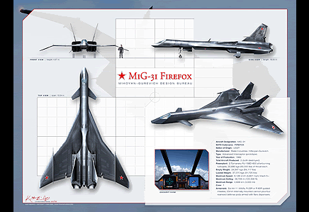

Is there any way to figure out what kind of plane this thing is off of? Any ideas, suggestions?
clearly its off the Firefox
