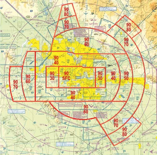

Well I know we have a bunch of PHXers here. The FAA has been trying to change the bravo around for awhile and IT has shown up again. What do you think of the changes?
Click on Image for bigger picture.

Are people generally against it? From looking at the proposal over the current TAC, I actually like it. I like what the proposal is for the airspace near the Estrellas, southeast of GYR. And I also like from the surface area to where Chandler blvd is, that the floor is increased to 4000.
Only thing I don't like is the airspace for the arrivals from the southeast, just south of Gateway. But I suppose it's not that big of a deal since we rarely get above 7k in the practice area.
Other opinions?

It's been awhile since I've flown into Steller, but I seem to remember the Class B near there was something you had to be aware of.
Only up to 9k still huh? Interesting.
Hope this change is actually beneficial to the local training environments.
I don't have any problem with the new Bravo. Lowering the top down to 9K will help alot, specially during summer getting over the top.
What I do have a problem with is Luke AFB wanting there own Terminal Area that would take over the whole North West Practice Area.
You just couldn't climb above 3,000 if you went north of the runway (and chandler blvd) much. Looks like the proposal would bring it up to 4k, which would be nice for people who fly out of P19.
That arrival corridor south of IWA looks like crap. There is a good reason for it as we got really close to some arrivals when I was instructing out there. I know it's not normal to get above 7K but when you need a 6000 AGL deck to complete an engine shutdown, when it's hot, I normally started at 9000 or 10000. I guess multi ops will just have to move farther south.
I loved flying into that airport. I agree, raising the shelf there is a good idea.
