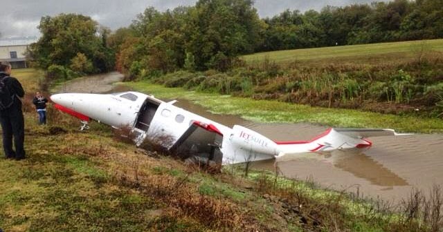

Do you have any more pictures? I am just surprised at how good a shape the wings are in not much crumbling just broke off
There's not a lot holding those things on and in normal use the attach fittings carry relatively small drag loads and lots of lift loading.
They're really lucky the fuselage didn't separate and continue rolling into the river just out of sight in the picture. That plane is a death trap waiting to happen.
Wow I didn't realize it went over the river...

That Diamond ;) hit a snow plow, and it took one wing off. This ripped the whole mother-luvin' wing, both sides still attached by the spar, off of the fuselage.
I guess them Brazilians can build a spar, but mounting it to a fuselage, well, that's another issue.
