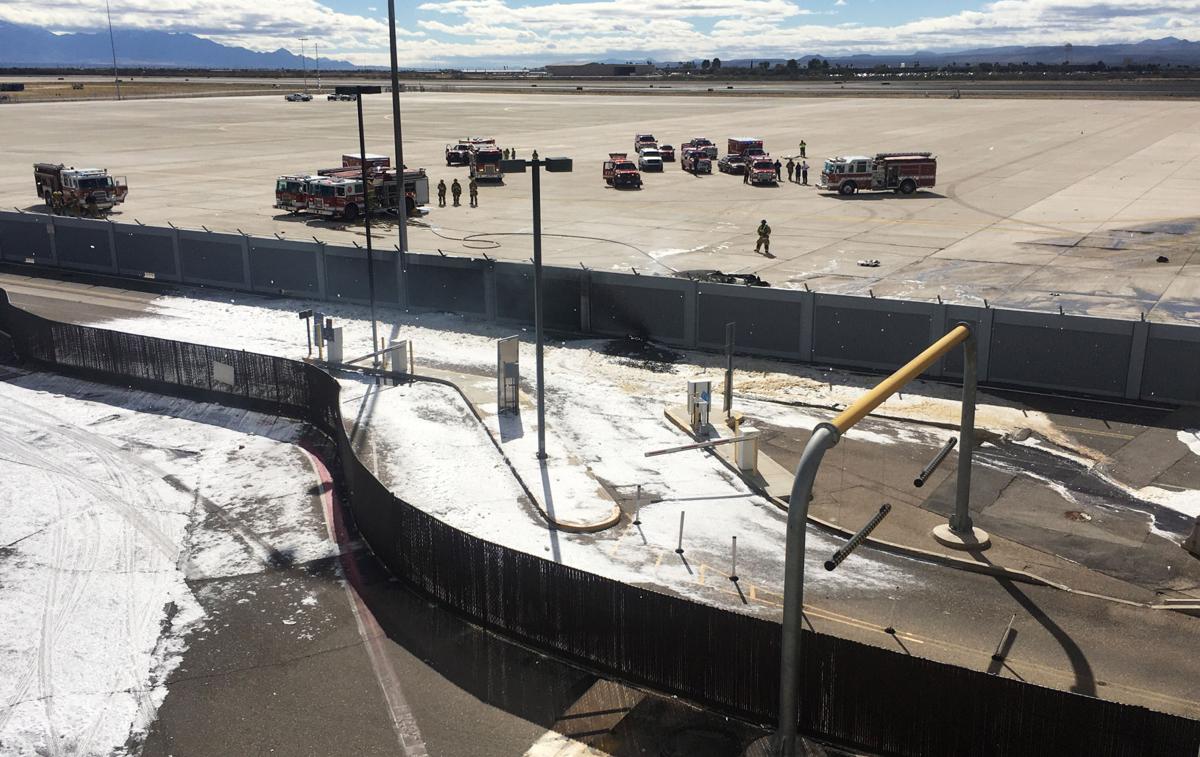

Even though TAAs crash trucks were very quickly on scene (TUS has a civilian airport CFR department as well as an ANG USAF fire department on field), but their crash trucks only have 1 crewmember onboard (common, actually) so all they can do is fight fire from in the cab. But in the video, TAAs Engine 761 was also on scene with their crew too. But the ANG CFR trucks aren't in that video because they're waiting to cross 21, like you heard on the LiveATC recording. I'm trying to find out what the actual delay was, and how legit it was, because that truck was holding long enough to have to remind the ground controller that "hey, I'm still waiting to cross here!".
