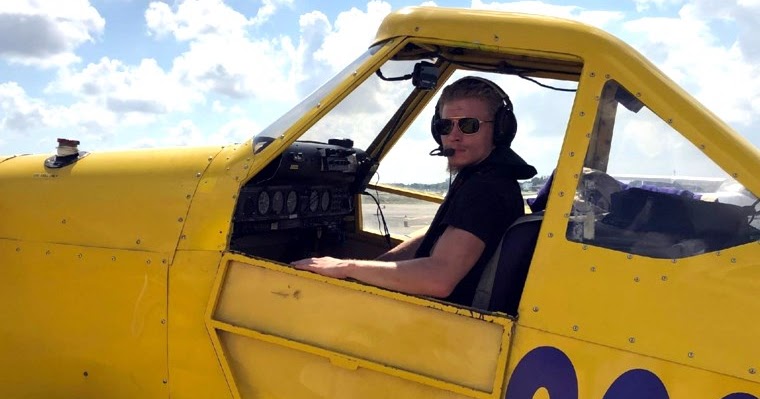

When you guys say fuel tank between your legs, are you just talking that general area? I towed gliders in two -260Cs and a -260D and both the Cs had the hopper removed so it was all open inside and a header tank forward of the instrument panel.
Similar to this:
Looks like the fuel tank comes pre-molded into the sheet metal skin just forward of the cockpit, which is why they’re able to poke the fuel quantity indicator out the top in the little plastic dome:
To be honest I preferred the Cs way more than the D with wing tanks due to the complicated fuel system as previously mentioned. But I get the point that having a header tank in the cockpit with you is disconcerting and sketchy during a crash.
With all the wing and horizontal stabilizer attach point inspection ADs due to the pesticides eating away the steel mounts, and the fact that the wing struts are loaded in compression instead of tension (and thus much beefier due to being prone to buckling unlike a high wing), I wasn’t sure whether I was going to die first from a tail falling off, a wing falling off, or a post crash fire.
I constantly miss flying that airplane but seeing that photo on the news of the cockpit fully engulfed was very sobering.
Yeah, just the proximity of the tank. Not that it would be easy to nose over a Pawnee, but if you somehow did, it is exactly the place you wouldn't want to rupture a fuel tank. Otherwise, they are great airplanes to fly. Does great on turf, easy to land, hard to ground loop, flies exactly like you would expect it to.
